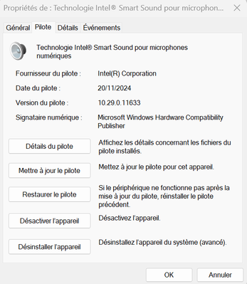

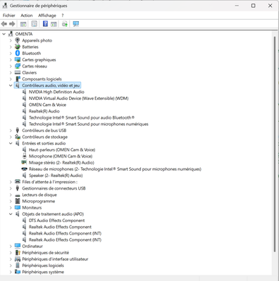

Hello,
I am experiencing an issue with the microphone on my HP Omen laptop. After updating Windows and my drivers, the microphone is still not working. I have already tried the following troubleshooting steps:
  • Ensured microphone permissions are enabled for apps
  • Deleted and reinstalled the microphone drivers
  • Rebooted the laptop and checked for updates via Microsoft
  • Updated all drivers, including the audio drivers
Despite these efforts, the microphone still does not work. Could you please assist me in resolving this issue?
Thank you for your help.
Taliboss10_0-1739795989604.pngTaliboss10_1-1739796017744.pngTaliboss10_2-1739796034199.pngTaliboss10_3-1739796101617.png

Check if the Microphone is Disabled in Device Manager
  • Open Device Manager (Win + X > Device Manager).
  • Expand Audio inputs and outputs.
  • Right-click Microphone Array, and select Enable device (if disabled).
  • If the issue persists, try Uninstall device and reboot your laptop.
