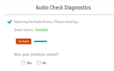

I went through the Support Assistant and all Windows updates. After the factory reset and both times all I get is the question in Support Assistant "Did you hear sound from the speakers?" And if I plug in headphones, Yes I get sound, if I disconnect the headphones, No. When I run the Audio Check and click Test Audio below, I hear the test music from headphones, but not from the speakers.
And while it plays the test music the audio levels will change like normal. If I get out of this screen and get back to the F2 System Diagnostics, the Audio Playback test is successful.
