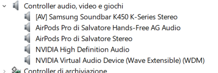

Hi, I have problems with audio and microphone. they are not detected by the pc. i tried to update the drivers but it doesn't work. i tried uninstalling and reinstalling the drivers but it doesn't work. sorry for my poor english.

I reviewed your post and I understand that you are facing issues with the audio.
Don’t worry, I assure you I will try my best to get this sorted.
I recommend you run the audio troubleshooter and it will automatically find and fix the audio issue.
Here is how it is done.
- Launch Troubleshooting by typing and clicking “Troubleshooting” in Windows search.
- Click on "Playing Audio".
- Follow the on-screen instructions.
If you continue facing the issue, then uninstall the audio driver from the device manager and then download and install the driver from the below link.
https://ftp.hp.com/pub/softpaq/sp107001-107500/sp107247.exe
- Type "Device Manager" into the search field to open the device manager console.
- Expand the node that represents the type of device that you want to uninstall, right-click the device entry, and click Uninstall.
- On the Confirm Device Removal dialog box, click OK to start the uninstall process.
- When the uninstall process is complete, remove the device.
NOTE: On the Confirm Device Removal dialog box, click the Delete the driver software for this device option to delete the driver package that was used for the device.
