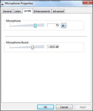

  3. With the device selected, click Properties, and then click the Levels tab.
Figure : Microphone Properties: Levels tab
  1. Adjust the slider to 75.
  2. If Mute is on, click the mute button to un-mate the device. The mute button should show as a blue speaker without a red circle.
  3. If Microphone Boost is available, adjust to +20.0 dB.
  4. Click OK to make the changes.
  5. Test the microphone using the instructions in Step 1 to determine if Windows is able to detect a signal for the microphone or line-in being used. If you have performed all the steps and the microphone or source device still does not work, the audio ports or sound hardware on the computer might be bad.
