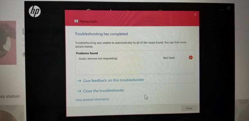

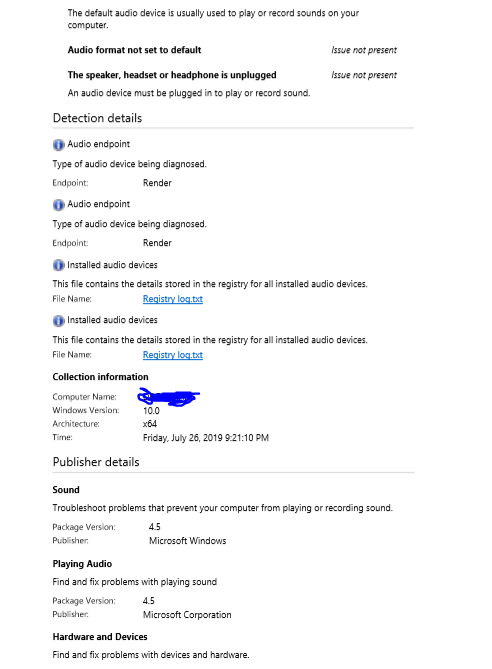

I tried all of the steps you outlined.   Nothing seems to work.   i have checked it using youtube and after about 10 minutes i get a message on youtube saying "if playback doesn't begin shortly, try restarting your device"  the video/audio loads just will not play.   so i guess whatever service is stopping after 10 minutes also disables video and audio playback too.  i did the bios update and the audio driver update.  i also did the windows -r and made sure the services app was set on auto and running.
I just ran the audio device troubleshooter and it lists video loading errorvideo loading erroraudio trouble shooteraudio trouble shooter

I've done that already too.   Problem still happens.   It's something between windows 10 and the hp motherboard or bios.    I did a factory reset lost everything but it will not go back to windows 8 so no matter what I do I am stuck with a 1200 dollar laptop from hp that only plays audio for 10- 20 minutes between restarts
