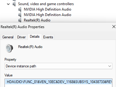

If not, then please bring up the device manager and identify the device the has the warning next to it, if any.
For example:
Lemme know if a problem

I need to know what audio device your system has. Please run msinfo32.exe and select "Sound Device" io the left panel.
In the right panel report what is used for audio. For example
Name Realtek High Definition Audio Manufacturer Realtek Status OK PNP Device ID HDAUDIO\FUNC_01&VEN_10EC&DEV_1168&SUBSYS_10438733&REV_1000\4&87D3799&0&0001 Driver C:\WINDOWS\SYSTEM32\DRIVERS\RTKVHD64.SYS (6.0.9400.1, 6.04 MB (6,328,568 bytes), 12/23/2023 2:51 PM) |
Information like the above can help identify the audio device so i can get the correct driver.
Were there any warning or cautions in the Device Manager? If so, what was marked as having a problem.
