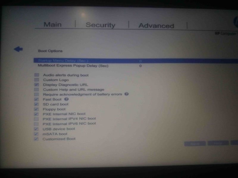

I have just installed Ubuntu 16.0.1 by complete erase of existing windows 10 on my EliteBook 840G1 , now i am getting error has Boot device not found , i saw some videos on youtube saying enabling and disabling legacy support but the thing is legacy support option itself is not there , i saw in some videos they have mentioned the option "secure boot configuration " in this we can find legacy support option but this "secure boot configuration " option also not there. I did all reseach but unble to find any solution pls help me.

This are the snaps .
Pls see attahced snps20180921_230146.jpg20180921_230300.jpg20180921_230318.jpg20180921_230420.jpg20180921_230456.jpg

Thanks David,
I am really newbie into this and don't knw about all these term but somehow i figured out to boot my system with ubuntu what i did is i went to Boot manger by F9 and then then i found some options there i went into \EFI\ubuntu\grubx64.efi and system booted successfully with ubuntu and then i went to Boot options by F10 and Add custom boot and in that i added that path  \EFI\ubuntu\grubx64.efi and restrated system and now its booting with ubuntu , however it stucking at purple window for 30 seconds intially at every boot up , but system booting up successfully.
If you're booting grubx64.efi then you probably want UEFI Native selected.
The 30 seconds is likely a timeout in grub to allow you to select alternative boot options such as booting single user for system maintenance purposes. I would investigate whether you can reduce that timeout to 5 seconds in the grub documentation.

Yes i had UEFI Native selected already ,
pls check snaps.
