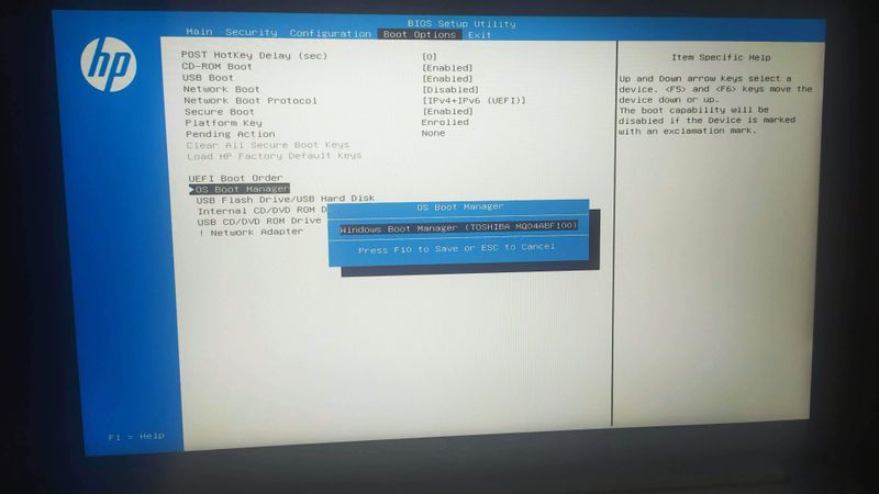

When I tried to change boot disk from BIOS boot manager, there was only one option Disk_0 (Toshiba, see in picture).
Then I tried to reboot with Windows Boot Manager (from win Settings).
Under menu "Use a device", there was a possibility to choose another internal hard disk, and when I choose the second one (Disk_1) Windows starts perfectly... (see in picture).
So how to make SSD drive (Disk_1) to be an option in BIOS os boot manager?

BUT no other disk options appeared in BIOS boot device manager.

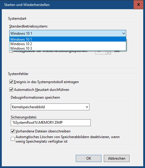

OK, it works but don't use the bcdboot-command if you don't understand the background.
In the advanced settings (RightClick This PC, advanced settings,  startup recovery) you see:
Here you choose which system you want to boot  the next time.
To check your bootentries run cmd (admin) and type
bcdedit
Here you can ruin your machine or you can make changes.
But don't go into BIOS
