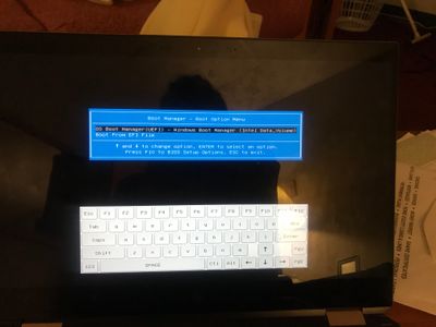

Also, my bootloader doesn't show ubuntu at the same place as I the picture you showed. For clarity, if I reboot holding down shift, I get this window
I can then choose Ubuntu, but it fails with "The selected boot device failed. Press <enter> to continue". This then takes me to the Boot Manager, which does NOT give an Ubuntu option:

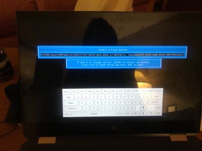

If I choose boot from EFI file here, I can go down a rabbit hole that leads nowhere:
which then just takes me back again to this screen.
