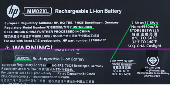

Hello @Ub6424
This is the original battery
WhatsApp Image 2022-10-22 at 17.05.24.jpegWhatsApp Image 2022-10-22 at 17.05.24.jpeg
And this is generic one i bought
WhatsApp Image 2022-10-22 at 17.06.14.jpegWhatsApp Image 2022-10-22 at 17.06.14.jpeg
Thank you.
When I had the original one before, the led didn´t turn on and it only had 10% left, that is why i search for the problem and it suggested me to change the battery, it worked cause it had like 40% then I got that one by recommendation and availability, changed it and it said as a ¨calibration method¨ to let it die and then charge it again. I did and never turned on. Just blinks 5 times and then stops and then 5 blinks again.
Hello @Luis1408
(1) Basically the replacement battery looks good:
They differ, but that is technically okay
Old:
4960 mAh
HSTNN-IB8Q
New:
4810 mAh
HSTNN-DB8U
( compatible )
