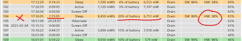

Hi. Randomly (but usually after extended runtime, laptop in use for a few hours and not hibernated/shutdown for a long time) the laptop will not sleep properly.
This is a modern standby laptop and it should consume less than 1W in sleep modeScreenshot 2023-02-11 011750.png
Sometimes it uses 6w in sleep mode, draining the laptop 20% battery in 1hr. This is unacceptable.
The green session at the bottom shows what it should be like, draining 10% battery in 7hrs. This worked because the machine was hibernated at 18:51 the previous day, it was started at 15:16 and then placed into sleep at 16:01.
