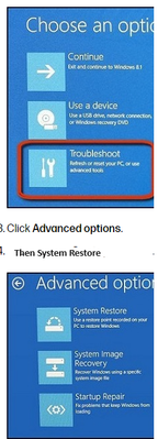

If you pass memory and disk test then try booting in windows safe mode, try a startup repair and if that fails then find a restore point.
Since Windows cannot start then you need to enter Windows safe mode from outside of Windows
First read this article about safe mode. Skip down to 'Enter safe mode from outside windows. If F11 does not get you into system recovery then try turning the power on and off three or more times in a row.
Since the startup repair fails then do the restore point.
This video describes how to use a restore point. Ignore that it shows windows working. Clicking on "System restore" will bring up the list of restore points similar to what is in the below video.
