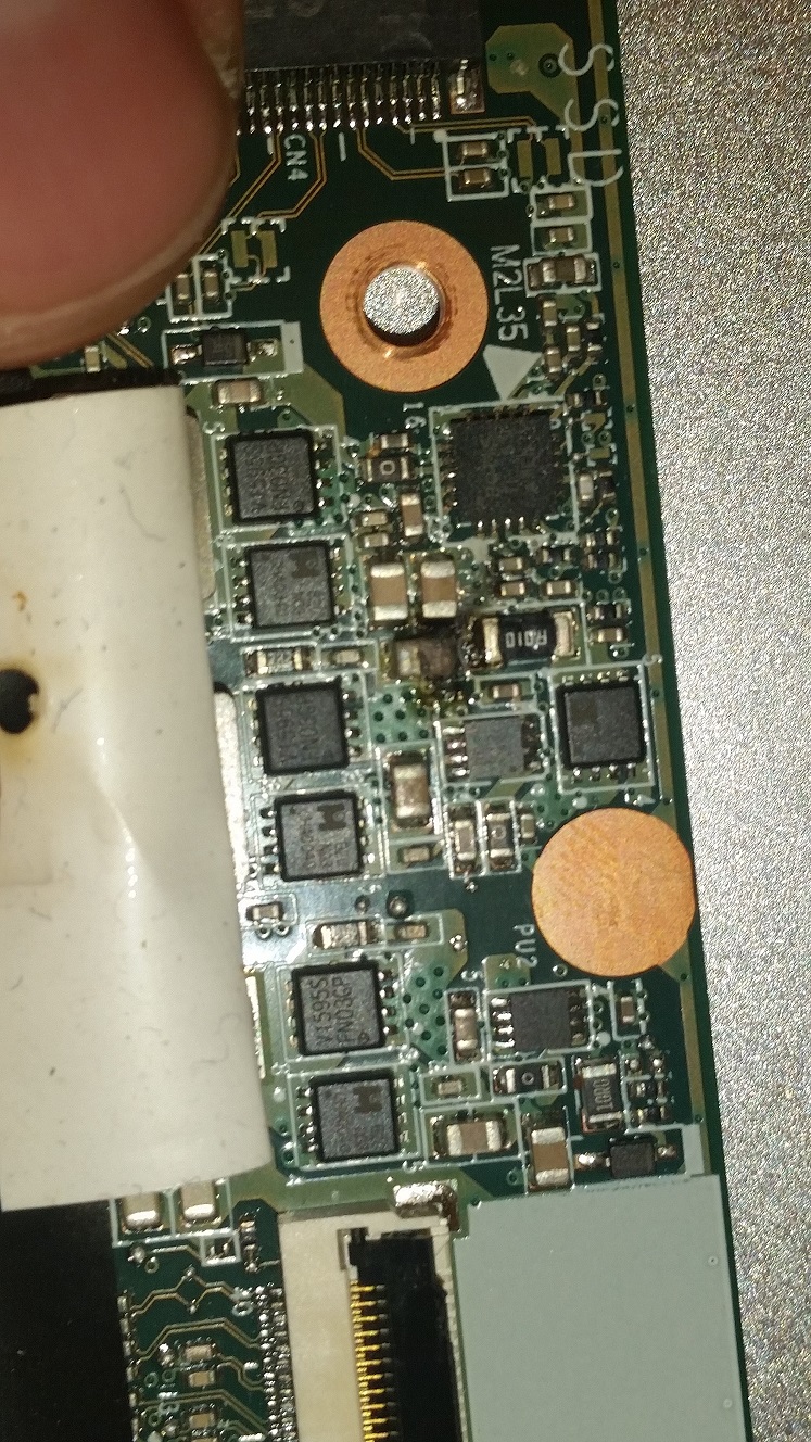

I have the same issue with the the burn spot on the motherboard.  I did find one pin of the power cable to be loose.  It was on the end next to the motherboard connection.  I called hp and they wat $450 to repair the board.  I tried to order the part but you cannot.  Hp got me too.20170111_194359.jpg20170111_194359.jpg
@ginovellie
  I have brought your issue to the attention of an appropriate team within HP. They will likely request information from you in order to look up your case details or product serial number. Please look for a private message from an identified HP contact. Additionally, keep in mind not to publicly post personal information (serial numbers and case details). If you are unfamiliar with how the Forum's private message capability works, you can learn about that here.
