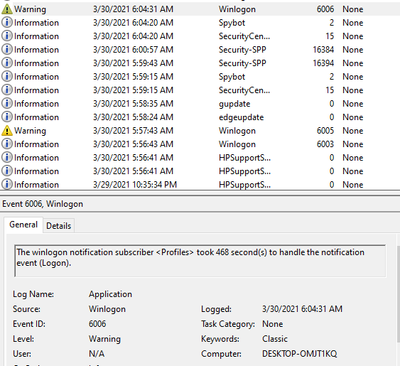

I will try starting in safe mode today and see what happens, I was getting an called PerfNet:
I was able to turn this off using a utility and now this is an error I get. It says it take 486 seconds (almost 8 minutes) to negotiate a logon:
I don't know if this is helpful or not. I will post what the behavior is when I boot in safe mode. Thanks for you help.
