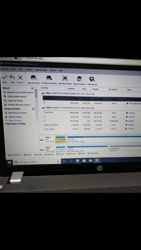

I ran the cloning process again with drivelock disabled, but in vain. attaching the minitool partition wizard screenshot after cloning, if that helps. pls advise.

The old HDD disk is MBR.. hope that won't result into any issue?
That is interesting.  The spec page says that PC came with Vista or Windows 7, which would have been before GPT.  It appears that the SSD is a Kingston and it has GPT listed.  Curious how that happened when the hard drive is a MBR which is where the Windows 10 is most likely installed and what should have been cloned to the SSD.  If the Migration software from Kingston is used instead of whatever you used, I would think that would/should solve that problem.  It is a forum of Acronis, which works very well IMHO.
