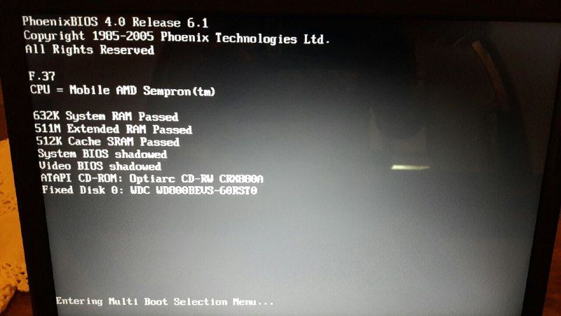

And actually, the biggest problem I´ve encounterd so far (this is why I made that "long story short" in my original post), is that for no apparent reason, If I stick a USB thumb drive with an OS ready to be installed on it, the system refuses to proceed to the "Select Boot Device" ... it just hangs in there ...

I sure did change the boot secuence so the BIOS gets to boot from the USB stick first but "that" is exactly where the system stalls ...
When I try to boot from the USB stick, the system stalls right here:
And when I reboot and press the ESC key so I can get to choose where to boot from, the system stalls right here:
Now, if I boot the system withoust any USB stick plugged in, I can get to the BIOS setup screen with no problem ...
Just in case, its worth mentionig that the very same USB stick boot without a problem on my other two test systems (Compaq Mini CQ10-120LA,  HP Mini 10).

Hi
Well I would also try a DVD.
It is possible that the system is not happy to boot from a USB.
