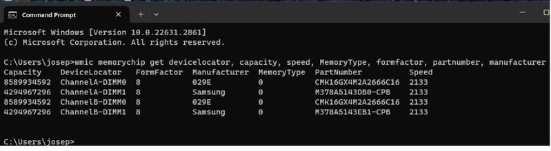

Should look something like the following.
wmic-x299

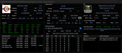

Now the intresting part, both CPU-Z and HWiNFO64 detect the rams in dual channel:
Here you can see it detects the Micron ram in slot 2.Here you can see it detects the Micron ram in slot 2.

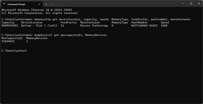

I am using the latest version of windows 11 and i have been using both those ram modules for over 2 years so there should'nt be a sudden compatibility issue with the ram, my laptop has always showed the max capacity and the ram size in this way i don't know why maybe it is a BIOS issue. I only updated the bios after slot 2 issue occured. Both memory modules work and boot the laptop in slot 1 and both the rams and the slot 2 are clean and even the socket-board joints are all good but still neither of the rams can't boot the laptop in slot 2. I don't understand if there is a slot or board issue then how is the memory being partially detected by the softwares or even the BIOS? I did what you asked and i swapped the ram modules, the previous CMD screen shot was of the ADATA memory, so here is a CMD screen shot of the Micron ram in slot 1:
Even the BIOS or OS here are detecting 2 memory devices.

Yea, there is a problem with the slot.  You could inspect the socket with a magnifier and light and possibly see some debris or corrosion.
There is something string going on as the part number is now shown by the WMIC command.  Clearly there is a difference if the part number for one stick of memory is shown but the other is not.
