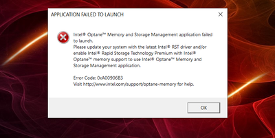

Also, after that diagnostic, my Laptop updated a program called "Intel Optane Memory and Storage", and showed me the next message:
I'm thinking that maybe when I reinstalled Windows 10 on my Laptop I needed a driver or something to make it recognize my 500 GB storage and not only the Optane memory. Do I need to format my Disk again or what could be the issue that is causing this?
