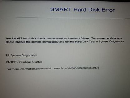

Then the problems started. When I restarted the pc after re-installing Windows, first a Windows 7 loading screen appears, but then the following error appeared:
SMART Hard Disk Error
The SMART hard disk check has detected an imminent failure. To ensure no data loss, please backup the content immidiately and run the Hard Disk Test in System Diagnostics.
F2 System Diagnostics
ENTER - Continue Startup
For more information, please visit www.hp.com/go/techcenter/startup
F2 System Diagnostics - Hard Drive Check does not find any problems. When I boot the pc from the windows installation USB-stick, a Black screen appears with white letters: Windows error recovery, with options to start windows as usual (which doesn't work) or to start the boot recovery (recommended). This boot recovery starts a program in Windows "boot recovery" that should automatically recover the computer, but it says it can't do this.
What I find remarkable is that the same happens when I insert the old, broken hard drive.
Does anybody know what's best to do?

The new SSD is new one and should be OK. Therefore the SMART error must have been a co-incidence.
As per this article >> https://support.hp.com/us-en/document/c01443502
The SMART Hard Disk test produces a prediction about the potential for hard drive failure, not an actual failure
And if Hard Disk Test passed, then you should not worry and use the computer as usual.
This means your PC actually did not boot from the USB stick but from the SSD and Windows 7 got corrupted there on the SSD. Actually, it didn't install completely the second time. This is the error message. Since the disk test passed, this confirms a software issue.
Test the USB stick - try to boot another PC from it
Attempt to boot from it again (F9)
Attempt to recreate it and boot again (F9) - perform clean Windows 7 installation by deleting all existing partitions

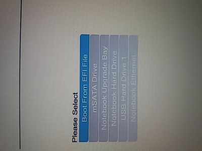

When I booted my pc by pressing ESC/F9, first this error appears:20171231_133257.jpg
And then this screen:
Then i press F9 and this window appears, with the bootable usb mentioned. This is the way I always booted from the usb:20171231_133728.jpg
When I boot from the usb, the same happens as I mentioned before.
There is the option of Legacy Mode, but the same happens as in the other modes.
