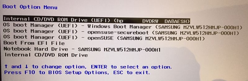

Now I can boot into Ubuntu from the BIOS boot options, which is fine.   I am wondering how to get those two old SUSE options out of there short of doing a complete system restore.
As you can see in my BIOS I can use the absolutely excellent implementation of GrUB by the SuSE software scientists, or switch to the Windows Boot Manager, can you?
And Debian and Lubuntu also use GrUB and will override the SuSE version until I correct it.
So where are you in placing GrUB as your Boot Loader that can be found by the BIOS?

I deleted the three linux partitions with Gparted and started the install per the link above, creating three new partitions from the new unused space .
Then I get this message:
The partition table format in use on your disks normally requires you to create a separate partition for boot loader code. This partition should be marked for use as “Reserved BIOS boot area” and should be at least 1 MB in size. Note that this is not the same as a partition mounted on /boot. If you do not go back to the partitioning menu and correct this error, bootloader installation may fail later, although it may still be possible to install the boot loader to a partition.
This link suggests solutions
https://ubuntuforums.org/showthread.php?t=2274184
it also suggests that I must boot the boot media as UEFI, which won't work.
The only way I can get the Ubuntu 18.04 disc to boot is the bottom option, the regular DVD boot option. The UEFI will NOT work
I guess I will try staring at the BIOS options a bit more...
