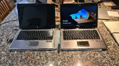

one works the lh one has no biosone works the lh one has no bios
Hi Hawks_Eye
It's me again!  I swapped the memory between these 2 laptops as discussed.  I also made a rescue disc from the rh one and tested it by booting from both lh usb sockets.  I tried in vain to reach a bios menu on the lh machine.  I also tried just one memory stick as suggested as well.  I might try cloning the hdd on the rh computer and putting the clone into the lh one.  The strange thing is that both these computers had the same problem initially but at some stage one of them found it's bios and then accepted a win10 usb install.
Regards, Teckienomore
