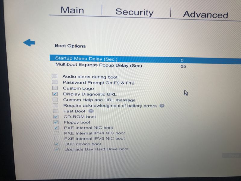

This error only can be solved if you install the standard HDD and de SSD m.2 drive at the same time
after install on the SSD and make wile installing also the HDD active as normal partition.(systeem reserve go's to HDD)
change in  BIOS Express menu time in seconds to 5 seconds and put the bios into Legency
after this you will have  to set the express boot menu in startup for 5 seconden's delay and no problem will occur anymore.
even in 2018 the BIOS software is not adjusted to resolve this issue
good luck

When you perform a clean install with Windows 10 Pro you will see the 2 disks.
1 is the 500GB HDD (or what kind of disk your may be using)
2 is the 32GB SSD M.2 into the WWan slot
when you create a partition on the HDD automaticly the systeem makes a new one of 500MB named Systeem reserved
than install the OS on your SSD M.2 after the install you can create on your HDD an partition for example Data
once you delay in Bios the multiboot Express pop up delay it with 5 seconds than when you start the systeem you will see the second picture, just do nothing and after 5 seconds your systeem will boot from SSD M.2
the systeem will boot now from SSD everytime you will boot your systeem
Multiboot pop up express to 5 sec delayMultiboot pop up express to 5 sec delayExpress pop up at start systeemExpress pop up at start systeem
