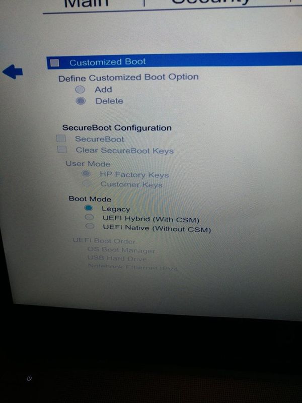

q1.jpgq2.jpgq3.jpgq4.jpgi have added more pictures. with the bios settings.the thing is that the chrome os stick that boots is seen in windows as ''efi-system'' ,this was made on neveware with their own software of making usb sticks, and the windows 10 stick that doesn't boot is seen in windows as ''uefi ntfs'' , this one was made with rufus

Hi:
Unfortunately, I don't know why it won't boot from the USB flash drive with those settings.
They look right to me.
