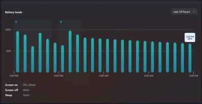

I have 1 wired headphones, mouse and keyboard connected to it. Last night, I shut it down at 87% around 1 AM and started it the next day around 4 PM. The battery was at 67% which is not normal at all (Please find the image attached).

The image you presented shows your system has been on the entire 24 hour span else it would not have a record of the battery rundown.

From the graph your show, it is clear you system is not turning off.  It is on and is recording the battery  level.
I do not know why it is not off.  Are you clicking on "shutdown" or are you just closing the lid?

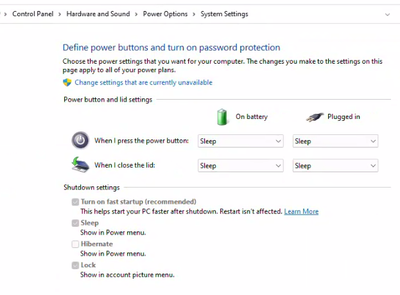

The following is from a laptop.  Note that shutdown defaults to sleep.  Please change to shutdown instead of sleep
