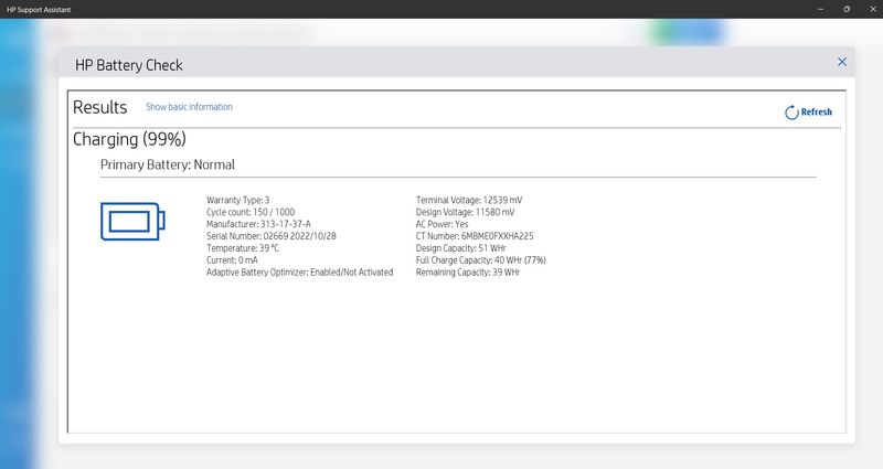

Today I performed a battery test again as you told me when the battery appeared.
The battery icon was showing today when I plugged in the charger on my laptop.
Let me share the screenshot with you.
Sufyan Sattar
I usually run the test from the HP Support Assistant because it gives the option to see more detailed test results. Like how many cycles on the battery, charge capacity levels of each cell, etc. You might be able to access that in the test logs in the test you posted. When the battery shows up it is apparently testing fine at least on the short test which just returns "OK".
Thanks for this information. I performed a battery test on HP Support Assistant, looked at the results, and guided me on the exact problem. The warranty on this laptop also remains.
