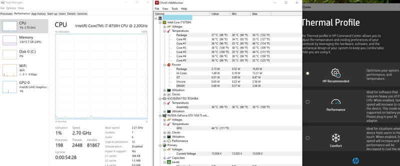

Here's a screenshot of the CPU usage, core temperatures and selected thermal profile...
For the whole of the 4 minutes that the CPU was around 1% shown in task manager, the fan was on constantly. Not on max, and not loud ... but still on and still whirring away quite irritatingly.
The ambient room temperature is around 20 degC (~68F)
