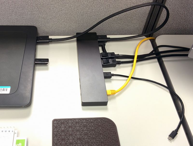

Dock for Zbook 15 G3 also running hot. Plenty of room around all sides of the dock. Updated all drivers the dock instructions listed including graphics drivers. Only items plugged in are:
  1. Display Ports (x2) plugged into HP E233 Monitors - 23" 1920x1080
  2. Ethernet
  3. Power adapter
  4. Thunderbolt / Power combo cord to notebook
Great pro advice on how to cool. What is official take on whether heat is normal? Thank you.
ZBook Dock has ample air flowZBook Dock has ample air flow
