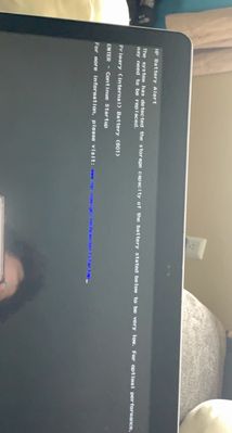

Hiii keep getting this message at start up. Where can I buy the replacement?
Model: W2K88UA HP ENVY m7 Notebook m7-u109dx

Hi,
The part number for the battery is 849314-856
You can try an online search with the part number to find a compatible battery
Example
https://www.amazon.com/s?k=849314-856&ref=nb_sb_noss_2
On page 26 of service manual you can see the steps to replace the battery
http://h10032.www1.hp.com/ctg/Manual/c05282360.pdf
Hope it helps,
