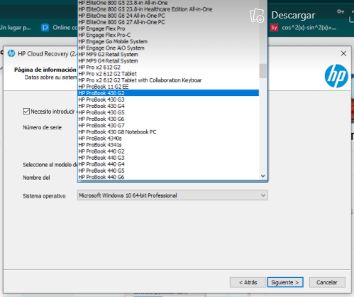

10-02-2020 06:06 PM - edited 10-02-2020 06:07 PM
Hi:
It looks like you did a great job with the drivers. Everything is installed with no ! marks in the device manager.
With the cloud recovery tool, try manually entering the product number of your notebook in the box.
If you have this model...that you showed in your driver page screenshot, 15-cc060wm, this is the product number...
1KU13UA#ABA
Manually enter that product number in the cloud recovery tool window and it will work.
I tried it on mine.
Check your notebook to make sure it is the same product number.
