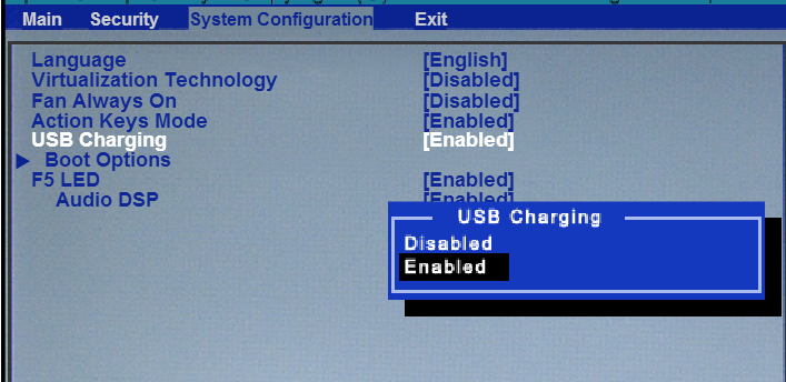

Nothing seems to stop the power drain after Shutdown!
I charged my Spectre to 100% and then selected Shutdown. I waited for the power white light to turn off before closing the lid. It seemed to hold charge @ 100% for about one day and then the battery power began to drain around 3-5% a day. I even disabled my USB Charging in the BIOS but it didn't work. I believe there is something draining the battery slowly. Either there is some hardware malfunction  or some apps are running silently to monitor the machine's activity.

@IanN1
Resetting the ACPI battery driver may take care of this,
There will be a hard reset mixed in as well, so the two methods combined typically help a lot with battery issues.
  • 1. Go to Start, search for Device Manager, and open this result.
  • 2. Expand batteries.
  • 3. Right-click on the ACPI option (usually the 2nd option) and select delete or uninstall. Follow the prompts.
  • 4. Shut down the computer.
  • 5. Disconnect the charger.
  • 6. Remove the battery.
  • 7. Hold down the power button for 1 minute.
  • 8. Insert the battery only.
  • 9. Attempt to turn the battery on.
    • If this had an impact, it should behave differently.
    • If not, Press the power button and then tap the F2 key to invoke the startup menu.
  • Choose and click on the F10 key to invoke the BIOS.
  • Use the System Configuration tab. Disable USB Charging and press the F10 key to save the changes and boot into Windows.

Spectre doesn't have a removable battery! Should I skip this procedure?
@IanN1
Thank you for posting back.
Yes! you can skip those steps and complete the ACPI troubleshooting steps.
