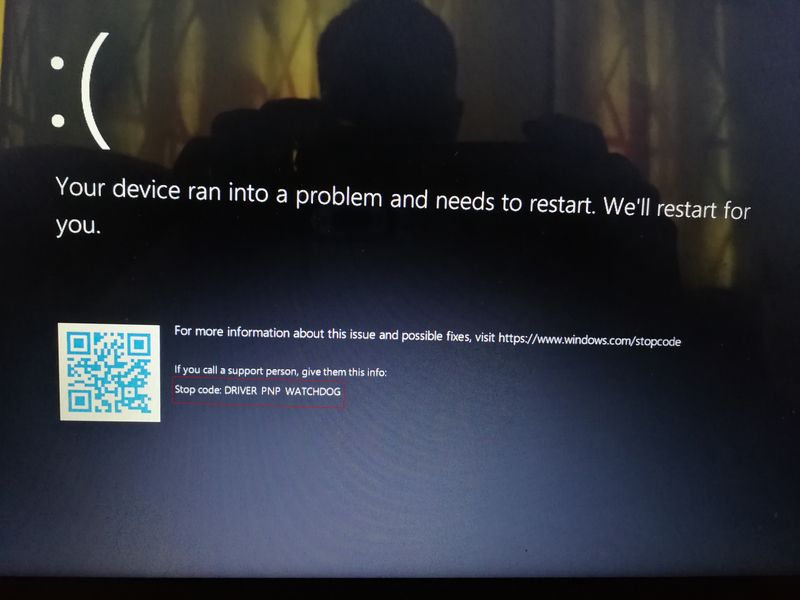

Good morning everyone. Hopefully someone has seen this and can possibly point me in the right direction.
So below you can see the error. This happens when using a USB device with Windows 10 or 11 to boot the system. Booting to the setup media (ISO) is done using RUFUS/VENTOY/E2B. Each one fails.
Setup ErrorSetup Error
There is an existing OS on the SSD, but the drive is failing so a new one is being installed. Would like to set up a fresh Windows but that doesn't seem possible. System will boot using other WinPE tools but just not the Windows installation media.

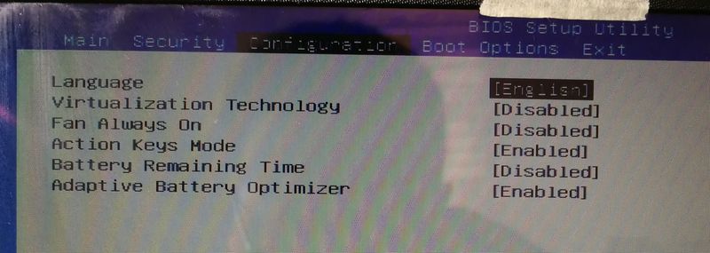

Initially I thought there may be some BIOS issue - so I booted using a WinPE and did the BIOS update to the latest version. Same issue in the picture above. Checks on the problem all point to some HDD configuration in the BIOS - maybe IDE/RAID/AHCI - but all things seem to refer to an existing installation that may have the issue. Nothing about a fresh install.

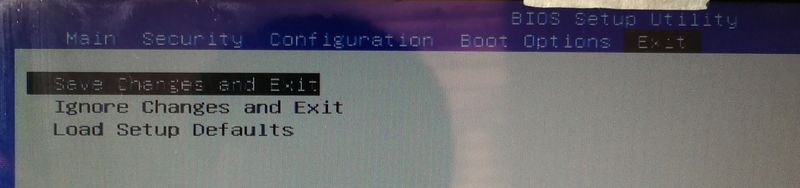

I've included photos of the actual BIOS settings from the device to show what the options are. There's nothing related to the drive configuration. Any assistance would be appreciated. I'd rather do a fresh install than having to clone the existing drive - the fact that it was failing may carry over some problems that I'd rather not deal with.
Sorry to hear that you are having problems ...
Does the same error happen when the Microsoft Media/Setup Creation Tool creates a bootable USB stick and you use it ?
Please report your results

Good day @Ub6424 - I didn't try that as yet as the other tools have historically worked. I'll test that and post back the results.
Good evening @Ub6424. I tried that and it didn't work. Same error after sitting there for a while. No different from when I used the other tools. Any other suggestion?

(2) Enter BIOS > menu [ Exit ] > [ Load Setup Defaults ]
then:
[ Save Changes and Exit ]
(3) Reboot and test again ...

I feel there may be some settings for the BIOS that are not visible - or just can't be changed - that's preventing this from going through. I've seen nothing to disable any additional security, no additional boot or drive options. Nothing.

Using the cloud recovery tool from the Microsoft store works. I've created the bootable USB. I've confirmed it works in another laptop quite fine. In the device in question - same driver PNP watchdog error...
Any other suggestions @Ub6424? Anyone else have any other things that could be tried?
I'm about at the end of my available options now. Nothing else I can think of...
Did I mention that I used a tool from within the WinPE that boots and tried to deploy the image to the drive? And that also failed? I mean - it deployed. But it just won't boot. It sits there spinning - no error - just spinning. I haven't left it for more than 10-15 minutes thereafter, but I guess I could leave it to see what happens.
My major concern now is that even the recovery USB created from the HP tool fails to load. So...
Help? LoL.
