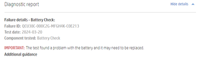

My battery will not charge. I get a failure id QCU38C-000C2G-MFGH4K-C0E213
Im not sure what this means or what i should do!
3 REPLIES 3
Enter the required information at the link below and it should provide a general overview of the problem and the most likely way to fix it.
HP Customer Support - Service Center
So I am taking it that I need to replace the battery?
Yes, that is what the report indicates.
