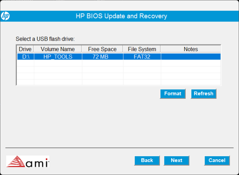

page after successpage after successfiles inside pendrive after flashing using toolfiles inside pendrive after flashing using toolit's formatted in fat32it's formatted in fat32
These are images from my friend's laptop, you can see that the tool is creating folders by itself, (fyi, im using 64gb usb 2.0 pendrive, allocated just 200mb for compatiability with bios, rest unallocated)
you say the files should be in root folder and not in folders right?
