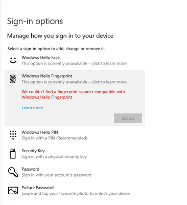

Hi,
I installed windows 10 and all the drivers for the fingerprint reader also unfortunately the reader does not work.
Hi, @SpyV2
The only software that has any chance of working on your model is this one.
The HP client security manager software replaced the HP ProtectTools security manager software.
If that doesn't work, then unfortunately I doubt you will be able to use the fingerprint sensor to log into Windows.
HP Client Security Manager provides enhanced Windows login and website single-sign-on capabilities. Security Manager is also the host for HP Client Security plugins, and therefore should be installed before other Client Security modules. This package is provided for supported models running a supported operating system.
https://ftp.hp.com/pub/softpaq/sp74001-74500/sp74101.exe

@SpyV2
Your machine probably very old. I did have one and disposed it few years back. From my memory, the fingerprint worked with Windows 8.1 but not Windows 10. Since it too old, I did not bother to find out.
Now, please check Hardware-id of the missing drivers and post back.
Regards.
BH
@SpyV2
Again, could be too old now. Can you actually get  their Hardware id's using the following way ?
     http://www.wikihow.com/Find-Hardware-ID
One of my notebook which is 11 years old and has FingerPrint reader. System knows it but no available driver for Windows 10. Vendors do not to spend money to support older products, making new products is cheaper.
Regards.
BH
USB\VID_138A&PID_0007&REV_0072
and there is an external program I could use to operate this fingerprint reader ?

@SpyV2
Please try and post back the result.

You're very welcome @banhien
I'm taking a shot in the dark on this one.
I'm pretty sure the Client Security Manager software for W10 that I posted works fine on the 2560p, but I don't know if it will work on the older 2540p, but it is the only software option that would, unless we provide the W10 Simplepass software.
We'll try that next if the HP CSM software doesn't do the trick.

Hey
I'm sorry I'm late, but I didn't have time. I installed the drivers and "Unknown Devices" disappeared 🙂. I also downloaded the HP Client Security Manager program, installed and configured it, and the fingerprint reader works. Before starting the topic I also tried HP SimplePass win10, but unfortunately the program did not detect the fingerprint reader and hanged during configuration.
Thanks for your help
