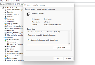

I clean installed Windows 11 to my PC recently. (I know Windows 11 doesn't support this model.) After I installed the OS and all the drivers that I downloaded from HP Sotfware & drivers. I couldn't seem to get Bluetooth to work. This model has a Broadcom Bluetooth. I tried update driver in Windows Device Manager, which didn't work. I also tried redownloading the driver and reinstalling it, which seemed to be installed successfully, no error or warning notification prompted up, which didn't work again. Please help.

But unfortunately both solutions you kindly provided did not work.
I tried installing all the optional updates in the Settings, which because I couldn't find any update labeled Broadcom. And then I restarted the PC, but the bluetooth controller earlier changed to Ralink somthing. Then I downloaded and installed  the driver you added in the link, and restarted the PC again, but to no avail.

Your notebook has the Ralink BT controller, so you can try the W10 Ralink BT driver.
There is no W11 Ralink BT driver.
This package contains the driver installation package for the Mediatek Bluetooth in the supported notebook models running a supported operating system.
https://ftp.hp.com/pub/softpaq/sp71501-72000/sp71572.exe

The driver of Mediatek worked. The Bluetooth is working now. But I wondered if I did something wrong when I was configuring the OS in the first place. So I went the extra mile and reinstalled Windows 11. I followed your advice from your first reply that I download the drivers from Windows Update in Settings. I did that. It also worked. I guess I have a Mediatek Bluetooth controller on this model afterall.
