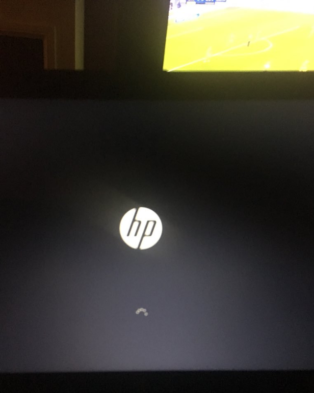

OK I downloaded windows to a USB drive and attempted to boot from the drive.
Boot Option Menu >> USB Hard Drive (UEFI) ....
I have one of the USB drives with the light on the end so I know it accessed the USB it but then the laptop immediately went to the HP screen with the circling dots.  The Windows installation windows never appeared.
Not my image but this is what my laptop screen looks like.

@BigD_NC
From your description, it sounds like the PC tries to boot from the USB stick, fails, and then resorts to booting from the hard drive.  Since you mentioned UEFI, this means you need Win10 media boot stick that was configured to use UEFI -- which from the actions, it looks it it was not.
So, download the Win10 install ISO file, then download and install RUFUS (a free utility for making boot media) which you can get from here: Rufus - The Official Website (Download, New Releases)
Then create the boot media to support UEFI mode -- and try again.

@WAWOOD
I am still having issues with this.  These are the steps I have taken (and the result is at the end).
  1. Downloaded Windows ISO file to my hard drive on my good computer
  2. Formatted USB drive to NTFS format
  3. Ran rufus 3.13.exe. and created the bootable USB drive
  4. On the broken laptop, I went into BIOS and disabled Secure Boot (per rufus instructions)
  5. Restarted bad computer and enter boot options
  6. Selected boot from USB Hard Drive (UEFI)
  7. The screen listed various items beginning with [Info} and when this process was done it went to the logo screen (hp logo and then under it the circling dots).  It stayed in this state for about 2 hours.  I'm assuming that the boot didn't take.
Is this symptomatic of a failed hard drive?
