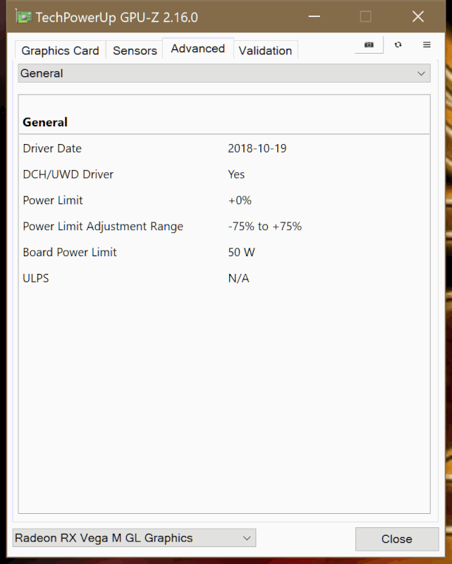

Does your Spectre have the AMD Radeon Vega graphics driver?  If so, as of now, there is no DCH driver for the Vega.  Intel does list an updated driver on their site, but it's not DCH compliant.  And add to that, they are listing it as BETA. AMD, from what I've read, has not endorsed the DCH modern drivers.  Until they do, my belief is that MS has blacklisted our machines since they have stated that DCH drivers are required for the 1809 update.  On the other hand, if your machine has the Nvidia graphics option, and still won't upgrade, well I guess I need to punt as I'm out of ideas.
HP Spectre x360 convertible - 15t-ch000 CTO, product 2FW62AV. Intel (Kaby Lake H) i7-8705G (3.1 - 4.1 GHz, 8MB Cache, 4 Core, + Radeon RX Vega M GL Graphics (4GB GDDR)16 GB DDRS-2400 SDRAM , 1 TB PCIe NVMe M.2 SSD (Toshiba), 15.6 4K IPS, Intel 802.11b/g/n/ac (2x2) Wi-Fi and Bluetooth 4.2 Combo. Windows 10 Pro
My vega driver is DCH
Our machines are not blacklisted, my Spectre x360 - 15-ch002nc is still showing 1809 update ready for install, and now windows update tried to install it by force outside active hours.... those stupids in HP should be kicked to ass every 10 minutes!
I did see this driver listed at Intel's site, but it didn't list it as DCH.  It only listed it as BETA.  At that point, I declined to even download it.
