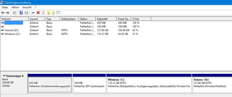

Thanks a lot! This seemed to be the right thing. After following all the prompts, however, I find that there is nothing new on my disk, neither viewed through disk management nor a partitioning tool. Where did I go wrong?

Thanks. After contracting a virus yesterday, I had to use an image to get me going again. Ie an image prior to the installation of sp80223.exe
So I could try again blank, with sp80721.exe this time, but at 1st glance, the result seems to be the same. See attachments: It used to be the 6th partition (relating to Minitool partitioner). And the computer was off after the installation.
But: Following your advice trying to access HP tools (which I had to find on the internet, not my daily business: F2 on boot), I discovered that they're still there. They're also on my identic machine (that serves as a reserve), however in an older (?) version looking quite different. So I assume that after making the next image and imposing it on the 2nd machine, it too will look likewise.
