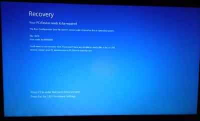

I tried System Recovery (F11), and it says "Your PC/Device needs to be repaired"
File: /BCD
Error code 0xc0000098
