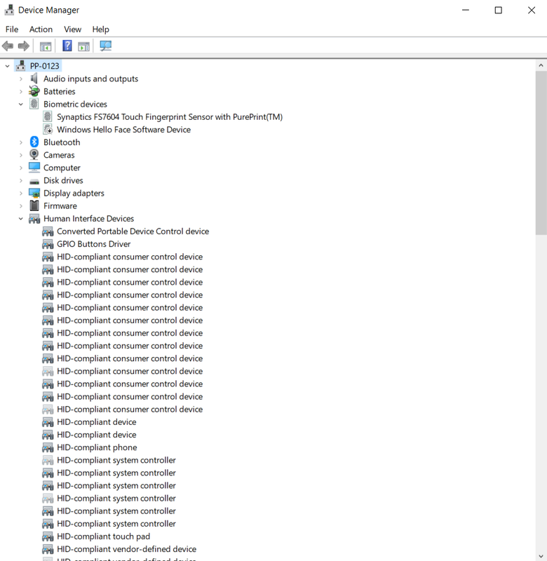

Send me a screenshot of windows device manager, look for unknown devices with a yellow exclamation mark.
Thank you again for looking into this matter and sorry for the delayed response. I have attached 3 images of all the items in Device Manager with the View option to include "Show hidden devices".
Hello @Nathan421
(1) Not related to your main problem ...
>WD SES Device driver
https://www.partitionwizard.com/partitionmanager/wd-ses-device-usb-device.html
https://support.wdc.com/downloads.aspx?p=258&lang=en
