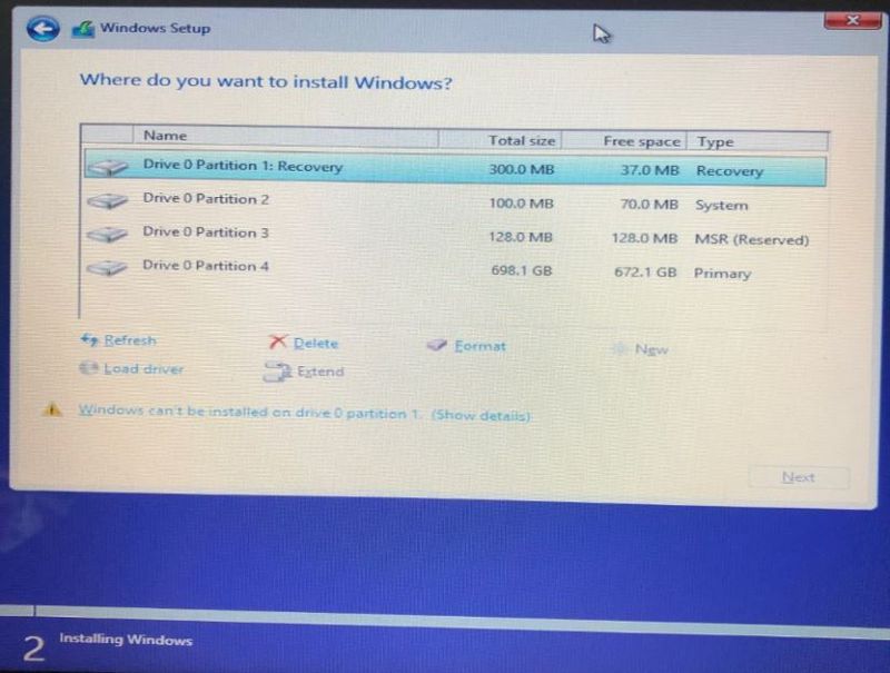

I finally got it to boot up through the USB installation media.
I would like to wipe everything and reinstall completely. This part is new for me, so I'm a little confused by this error. Do I need to install on Drive 0 Partition 2 or 4?
OK, great.
Click on each partition listed on your screen shot and click on the X Delete icon to leave only one partition.
Start with the first one you have highlighted.
Then click Next, and W8.1 should begin to install.
