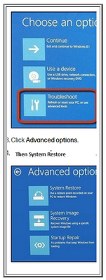

First read this article about safe mode. Skip down to 'Enter safe mode from outside windows. If F11 does not get you into system recovery then try turning the power on and off three or more times in a row.
Try that Startup Repair shown just above.
If that does not work then go for a Restore Point.
This video describes how to use a restore point. Ignore that it shows windows working. Clicking on System Restore will bring up the list of restore points similar to what is in the below video.
