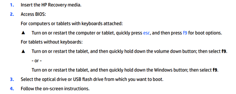

Most likely you created a bootable recovery usb drive via HP Recovery Manager. See the screenshot below of page 87 that describes how to run a recovery drive. It is basically the same as what I said earlier.
As long as your recovery drive is correctly created, it should be launched from F9. This recovery process will erase all the data on the hard drive, and there may be something else you may need to be aware of so read those pages before starting the recovery work.
