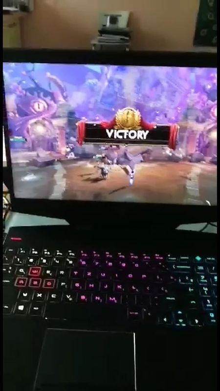

Hello guys, i recently bought new HP omen laptop, it works great for normal use, but when i try to play game,  in this case nothing special game, cs go which is not that strong , makes my laptop after sometimes 1 round,sometimes 2, sometimes 3.. freezes, while on charger. while playing it works fine, but when loading map it freezes. also i tried with SMITE game, same thing, after few games laptop freezes after game. i cant believe brand new laptop with strong specs i5 9900th GEN, 1T ssd, 16 gb Ram, RTX 2060, freezes after playing normal games after 30min....this beast gaming laptop should play games 24/7 on charger without any issue, but i cant play **bleep** cs go more than 30min while charging,,,,when it freezes i have to force shut down...and when not charging cs go works fine , i played 5 maps without any issue, i couldnt test further because battery runned out, so for summary, on charger i can play 1 -3 map max before it freezes(1 map last 10min because its DM mode), when not charging i play 5 maps (max maps before battery run out). Imagine if i start some heavy game like COD, this laptop would probably explode.....What can cause this problem?  should i return this laptop and ask for new or just get the money back and buy anything else but OMEN, i am so dissapointed  in that brand!  this expensive laptop giving me headache and additional stress in this crazy world atm is unacceptable. please review this and tell me what is the best solution to this and what can cause this, oh and btw while charging and doing normal tasks, like facebook,browsing, youtube...works fine, so i guess giving him harder tasks while on charger makes him freeze *after 20-30min*. sorry for longer post.
thanks in advance. SMITE ss is bad quality because i ss from video ,after this freezes i can only force shut down laptop...109720684_333652880988712_4691058415596868379_n.jpg109840074_316347482836842_8002598732539421998_n.jpg

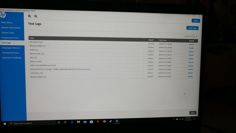

Hello again!
Thank you for your patience and time !
I run those 2 tests like you said. every test passed. i will post pictures.
i ran both System Fast Test and System Extensive Test. for this extensive test it says it will last 2hours or more, but it lasted like few mins, same as fast test. both test were done in like few mins, is that because this laptop is fast and have power components?  How accurate are those tests? What now when it shows everything is fine, but it actually isnt ?

@markustribo,
Thank you for the update.
Looks like the hardware on the computer is working fine and the issue seems to be with the operating system.
I recommend you perform a cloud recovery following the steps in the below article and check if it helps.
