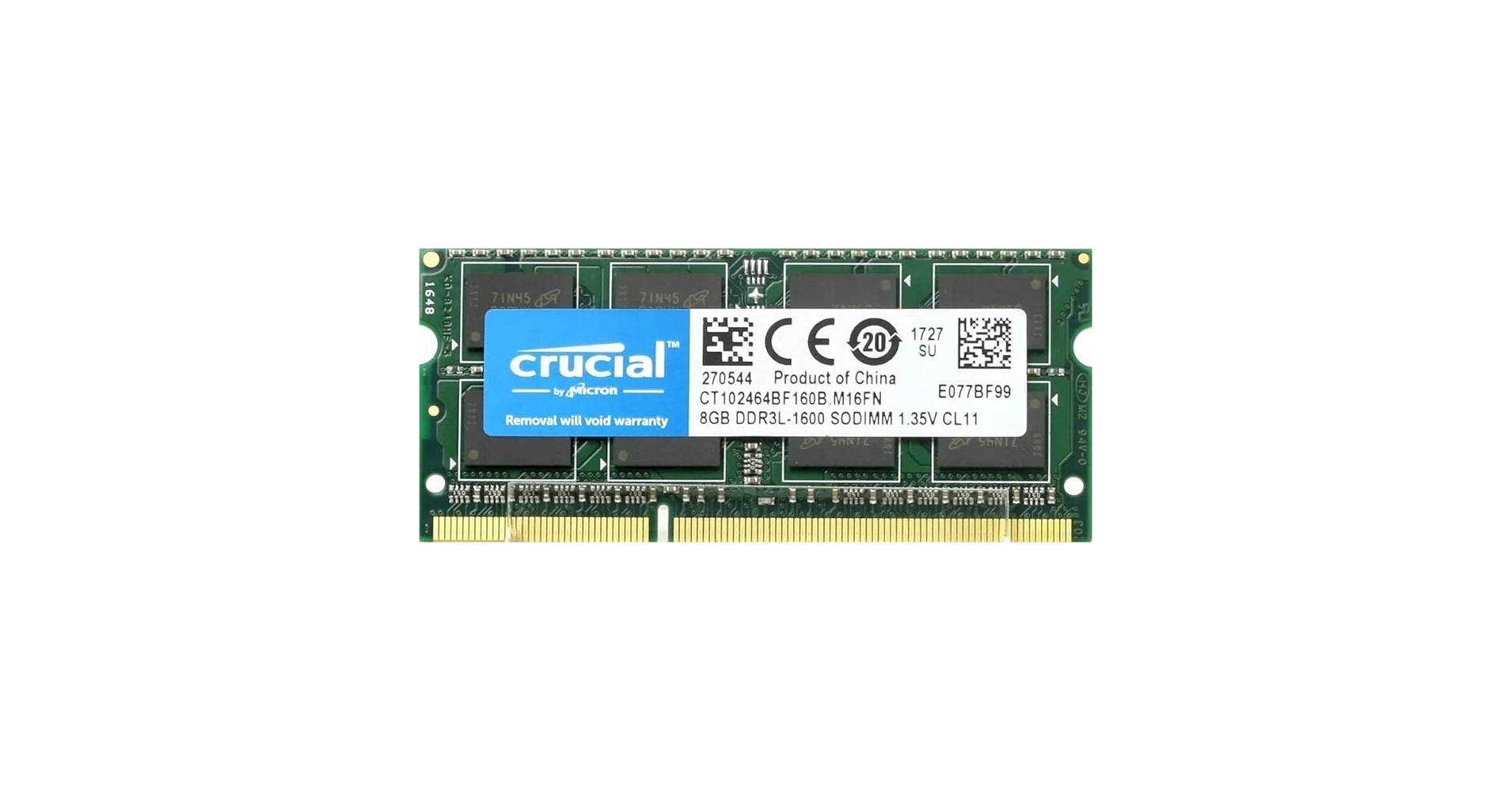

The notebook can support 2 x 8 GB of DDR3L-1600 memory.
This would be a compatible 8 GB memory chip for your notebook.
Amazon.com: Crucial RAM 8GB DDR3 1600 MHz CL11 Laptop Memory CT102464BF160B : Everything Else
After you open up the notebook and figure out what memory is installed, if they are only 4 GB memory chips, you may want to replace them with two of the above chips and max out the memory to 16 GB.
