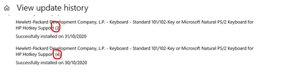

Hi There,
I am having the same issue, except I have not been able to find that driver for my laptop to install (as you mentioned to do).
Also when looking at windows update is says that the update has installed like 4 times (see screen shot)
But still wants to be installed. My laptop (in the last 3 days) has started running very slow compared to normal and the fan is constantly running even though the laptop is is cool, CPU usage is under 2-3% and the fan is running like a dog.
After a lot of investigation I am lead to believe that this might be causing it as this is classic how the laptop acts when performing updates.
I have tried the above suggestions too.
