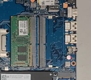

I suspect there is a hardware problem as the WIN+B works randomly.   If memory is bad then flashing a new bios can corrupt the system.
Watch disassembly video, remove both memory, clean them with eraser tip, and put one of them in the inside slot.  Note  that the author attempted to use superglue to do a repair and the repair failed.
Hold down the power switch for 20 seconds and see if it boots.  Try the other memory if it does not.
