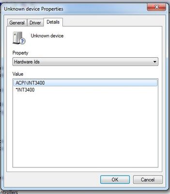

Everything went great almost there I have the pictures of the unknows20170326_185421_2.jpg
See if this driver works for the PCI Data...I thought the Thermal Dynamic driver is supposed to install that device.
The 2nd file down on the left is the auto install file.
https://downloadcenter.intel.com/download/20775/Intel-Chipset-Device-Software-INF-Update-Utility-?pr...
Please post the hardware ID's for the two unknown devices.
Will be putting your last post fix in tommorow to late tonight
Again Thank You
Any ideas on the problem shown in this picture
Thank you in advance Cadman500
I can give you the driver for the 6007.
You need this one...
Receives notifications from the integrated accelerometer and automatically parks the hard drive to reduce the risk of damage if the PC is accidentally dropped.
http://ftp.hp.com/pub/softpaq/sp77501-78000/sp77869.exe
The other device...INT 3400 also should have been installed by the below driver...and if that driver doesn't work, I don't know what to tell you because that is the latest driver for W7.  You can try the W10 version from your notebook's support page and hope that it works, would be my only other suggestion.
