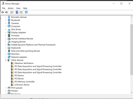

I have a blue screen problem and I suspect this could be causing them. I need help with the drivers and possibly a fix.

Hi:
Most of the missing drivers for the devices in your screenshot will be installed by this driver.
Intel Chipset Device Software
https://ftp.hp.com/pub/softpaq/sp101001-101500/sp101171.exe
Restart the PC after installing the driver.
This driver should install one of the PCI devices:
Realtek Card Reader Driver (Windows 10
https://ftp.hp.com/pub/softpaq/sp87501-88000/sp87989.exe
The detection verification device is installed by the Realtek audio driver:
Realtek High-Definition (HD) Audio Driver
https://ftp.hp.com/pub/softpaq/sp103501-104000/sp103860.exe
The other of the 3 PCI Data Acquisition and Signaling....should be installed by this driver:
Intel Dynamic Platform and Thermal Framework Client Driver
https://ftp.hp.com/pub/softpaq/sp96501-97000/sp96724.exe
If there are any devices missing drivers after you install all of the above drivers, please post the hardware ID's for the device(s) that need drivers.
Use this guide for how to find the hardware ID for a device:
How to Find Drivers for Unknown Devices in the Device Manager (howtogeek.com)

However, i still have some still in error,
Could you help me out?
i got this cmd window open-up after installing the chipset driver.  what went wrong?
These are the remaining errors. the I.Ds are:
1. PCI\VEN_8086&DEV_9D27&SUBSYS_83B9103C&REV_21
2. PCI\VEN_8086&DEV_9D29&SUBSYS_83B9103C&REV_21
3. PCI\VEN_8086&DEV_9D35&SUBSYS_83B9103C&REV_21
4.  ACPI\INT33D6\2&DABA3FF&0

See if these drivers work...
First and second devices:
Intel Serial IO Drivers
https://ftp.hp.com/pub/softpaq/sp92501-93000/sp92587.exe
Third one:
Intel Integrated Sensor Solution Driver
https://ftp.hp.com/pub/softpaq/sp87501-88000/sp87986.exe
Last one:
Intel Virtual Buttons Driver
https://ftp.hp.com/pub/softpaq/sp87501-88000/sp87985.exe
Unfortunately, I don't know what those scripts are.
None of the missing drivers you had left are installed by the Intel Chipset driver.
Thank you Paul for all of your help. It worked !!! I will let you know if the bluescreen issue is resolved too.
