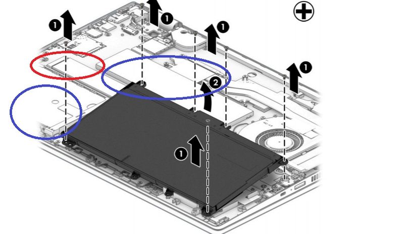

I just purchased an HP laptop in the same series. Mine is a 14m-cd0001dx and is pretty much the same as yours except 8 gigs of RAM. You have 2 speed bottlenecks...4 gigs RAM and the slow 5400 rom hard drive. Mine was actually pretty fairly useable with 8 gigs and I added an Optane module to speed up the hard drive. Made it much much faster.
Mine came with a single 8 gig module and an open slot and yours has a 4 gig module and an open slot.
Your Service manual
Start on page 30 to open the back cover and access the memory and M.2 slots.
red circle = M.2red circle = M.2
You see three zones above. The red oval is the M.2 slot where you would put an Optane module, the zone to the right of that is a metal shield that covers the memory slots and the zone below the M.2 is where you find the existing hard drive.
You need a 4 gig of DDR4-2400 to bring it to 8:
Your Service manual
